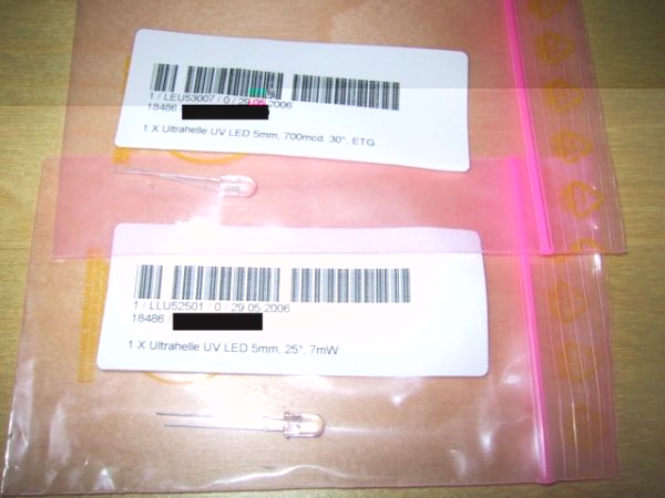

3. Ultrahelle UV LED 5mm, 25°, 7mW [LLU52501] 0,89EUR
4. Ultrahelle UV LED 5mm, 700mcd, 30°, ETG [LEU53007] 1,59EUR
so kamen sie an
